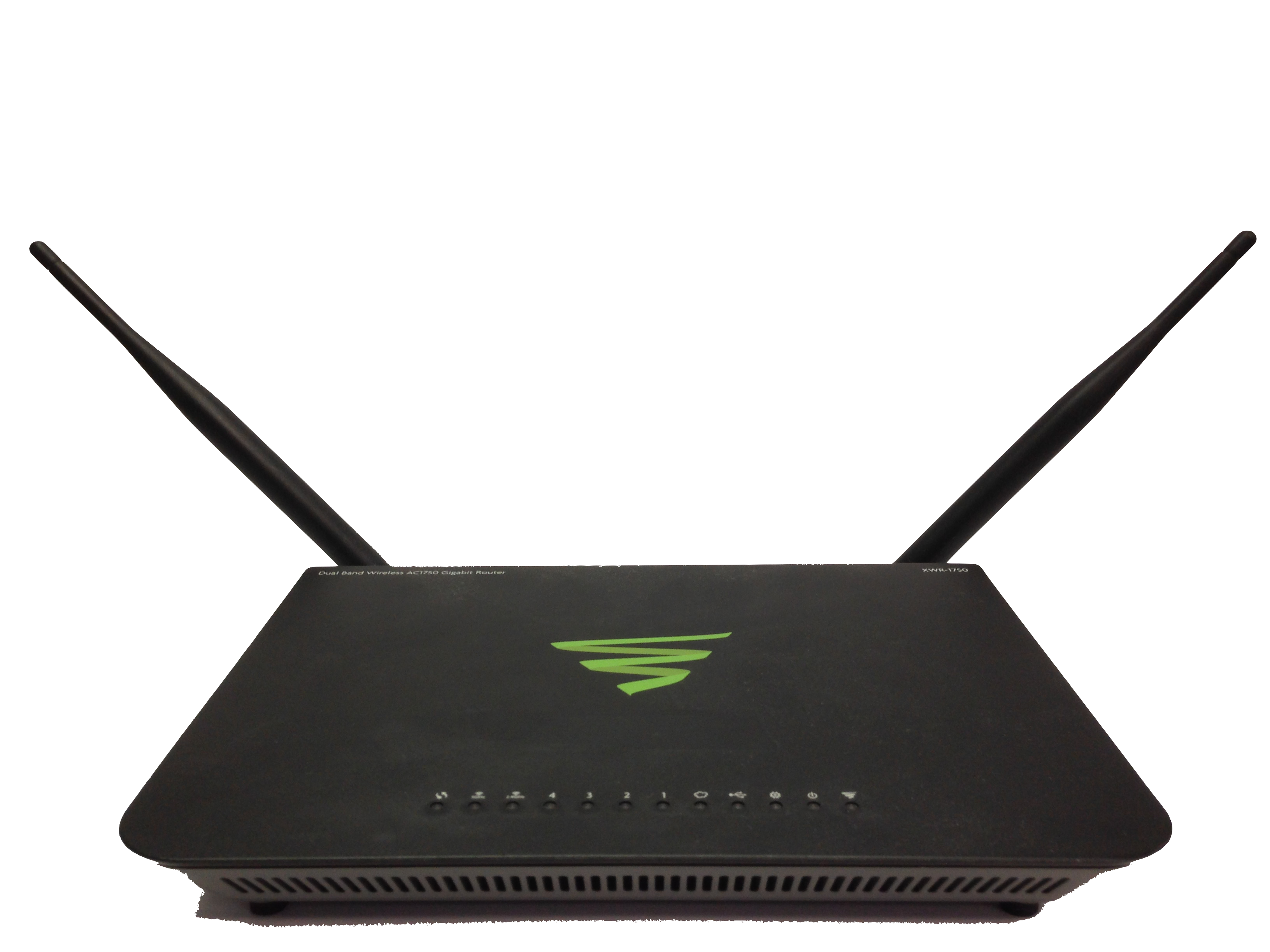

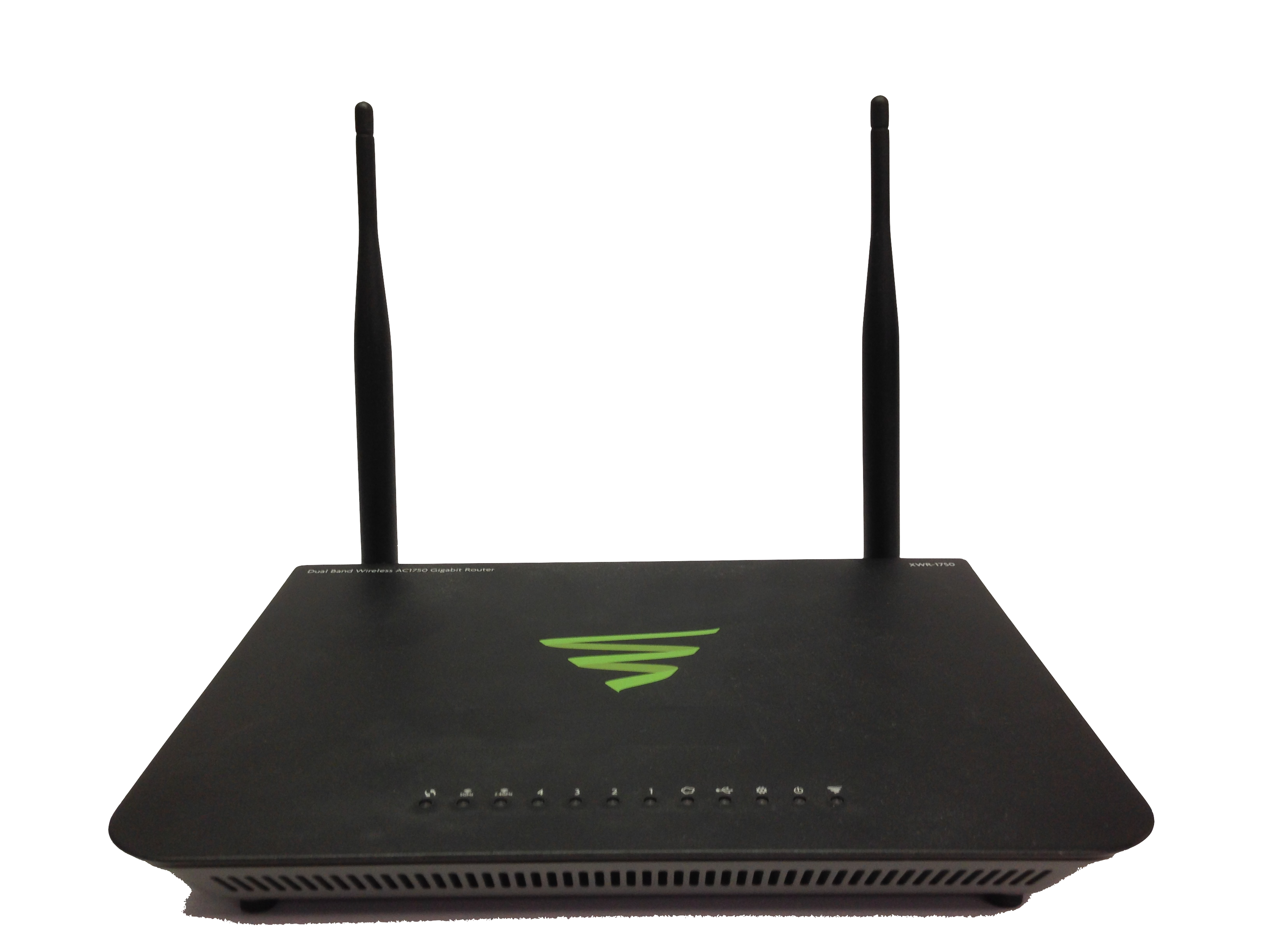

- Wireless signals radiate outward from the sides of the antennas on your router. Think of it like placing a doughnut on the tip of your finger, where your finger represents the antenna, and the doughnut symbolizes the direction of the signal waves radiating from the antenna. This concept resembles the ripples created on a pond when you toss a stone in. The waves primarily propagate in two dimensions, with limited vertical coverage. If you have multiple antennas all pointing in the same direction, it could be beneficial to reposition them at opposing 45-degree angles. This adjustment can enhance the ability of the antenna's signal to penetrate walls or floors more effectively.
