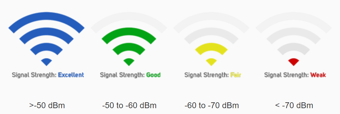

A graphical icon will show your current signal strength range. The signal strength will be listed as a negative number in dBM (decibel milliwatts) in the report below the icon. As the number approaches 0, the signal strength increases.
Note: Wired players (including players connected directly to a wireless media bridge or power line Ethernet kit) do not show the graphic of signal strength.
Players experiencing weak signal strength (less than -70 dBm) or insufficient signal strength will encounter inconsistent audio, resulting in disconnections, constant audio buffering, and potentially frequent disappearances from the BluOS Controller App or disruptions in grouped playback.
Players with Weak (<-70 dBm) or insufficient signal strength will experience inconsistent audio caused by disconnects and constant audio buffering. It may even regularly disappear from the BluOS Controller app or disconnect from grouped playback.
Here is a guideline for reviewing the signal strength necessary to achieve optimal performance with specific formats.
Wireless Signal Strength Requirements
- For Player Firmware upgrades: -70dBm
- For streaming 16-bit / 44.1 kHz content: -70dBm
- For streaming 24-bit / 96 kHz content: -55dBm
- For streaming 24-bit / 192 kHz content: -45dBm
