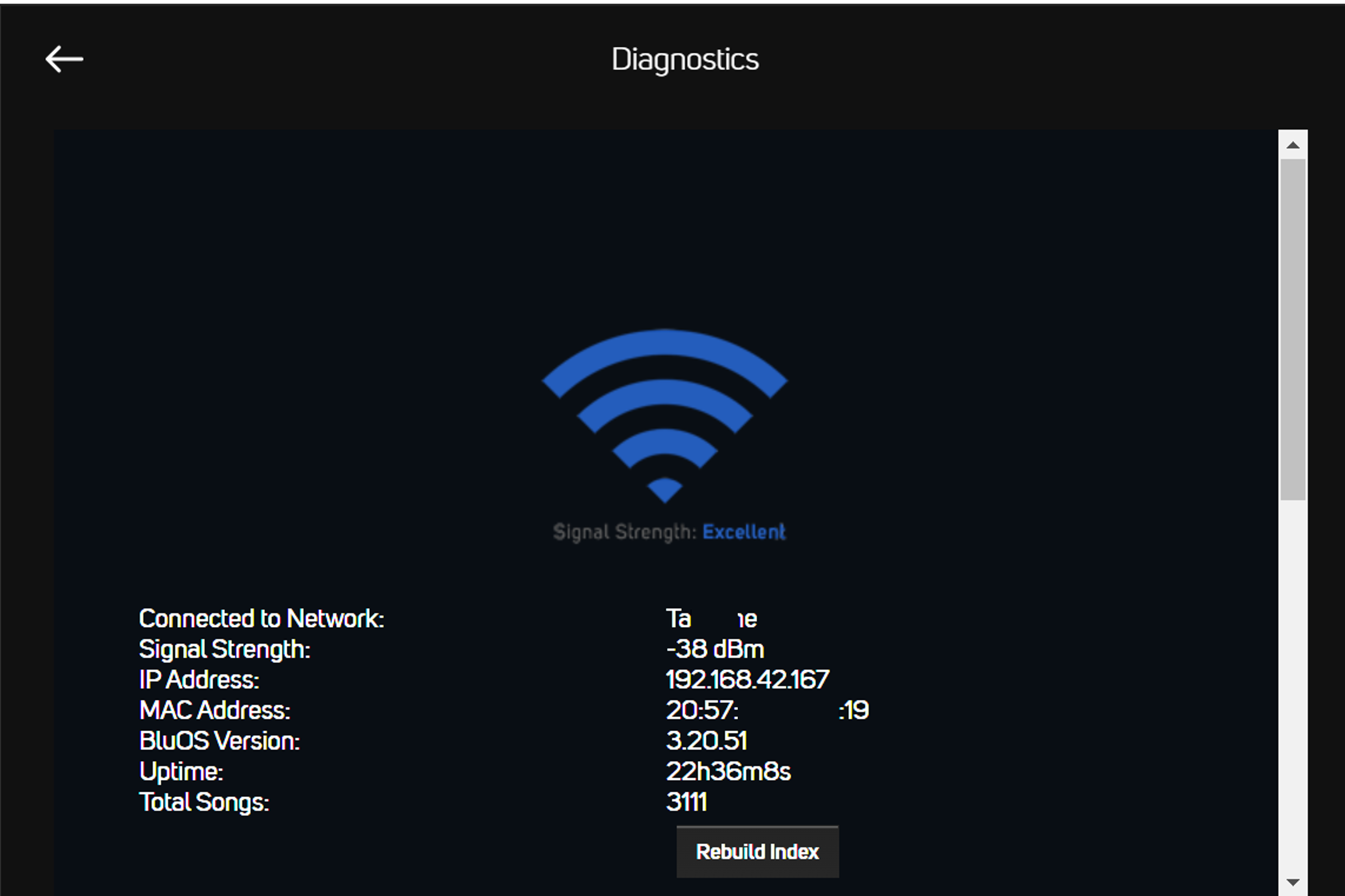

Wireless connections
The color-coded Signal Strength indicator, Network name, and dBm reading are displayed along with the IP Address of the network.

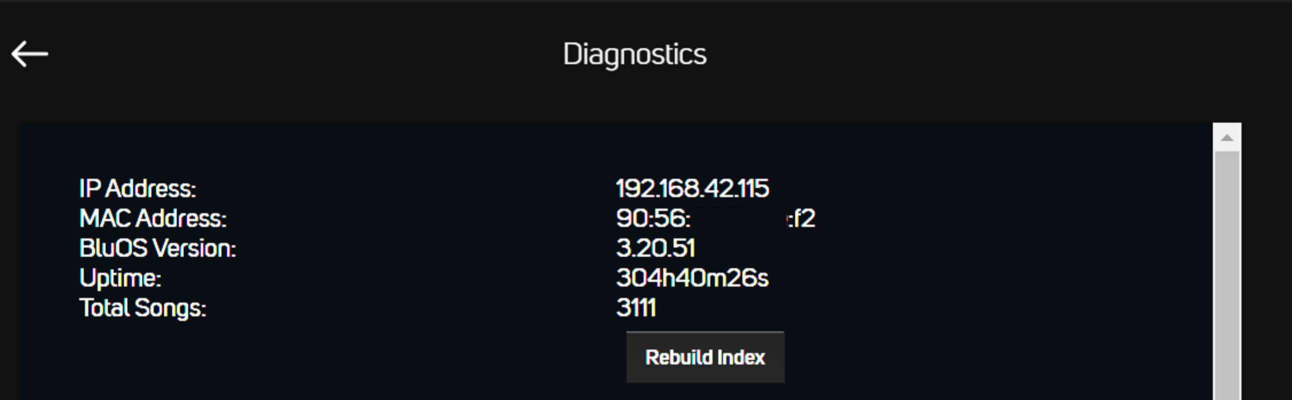

Ethernet connections
Only the IP Address of the network is displayed.
Notes:
- When an Ethernet connection is available, the player connects to the network using the wired connection by default.
- Bluesound players cannot connect using both wired and wireless connections simultaneously.
