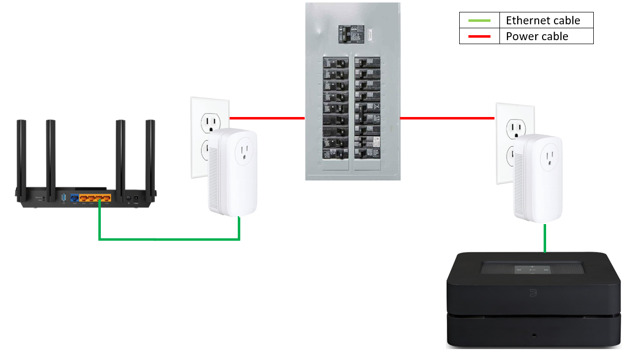

Ensure the powerline adapters have a simple circuit between them, as illustrated below:
Distance
To prevent dropouts and interference, it's essential to ensure that the circuit (wire) distance between two powerline adapters does not exceed 100 meters. This distance measurement refers not to the direct line of sight between the two powerline adapters but rather the actual distance to and from the circuit breaker.
