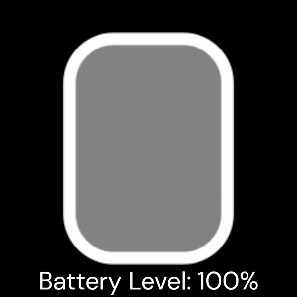

Once a charged BP100 is attached, the PULSE FLEX icon in the Player Drawer changes from Gray to Black. As power decreases, the PULSE FLEX icon will become increasingly Black. The PULSE FLEX or FLEX 2i shuts down once the battery is depleted.

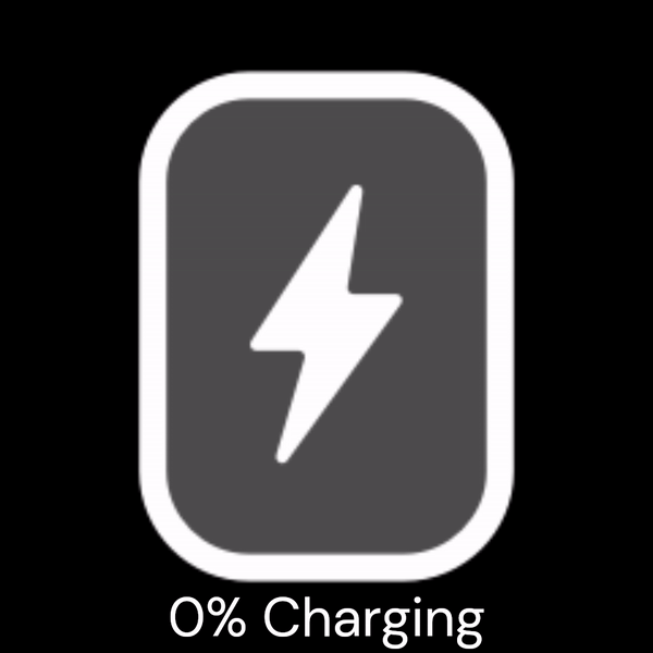

To recharge the BP100, reconnect AC power to your PULSE FLEX or FLEX 2i with the BP100 attached. A Lightning bolt symbol on the PULSE FLEX icon indicates that charging has commenced. The charging progress is also displayed. Once fully charged, the PULSE FLEX icon shows an AC power plug symbol instead of a lightning bolt, typically after charging overnight.
A PULSE FLEX / FLEX 2i running on battery
A PULSE FLEX / FLEX 2i charging
