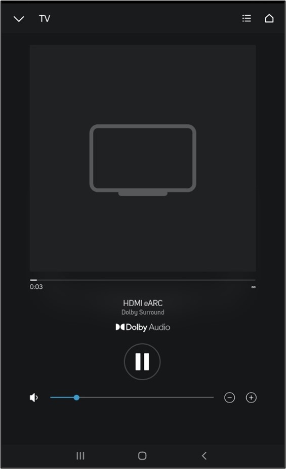

Dolby Indicator
The Now Playing screen in the BluOS Controller App indicates if the above Bluesound players are playing Dolby content.
