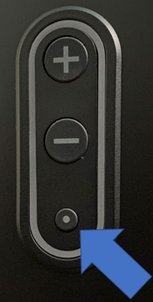

1. Network paired PULSE SUB+ (Ethernet/Wireless network connection)
When the PULSE SUB+ is network-paired to another Player, pressing the Function Button once will toggle the Player’s Subwoofer ON/OFF switch in the BluOS Controller App.
Subwoofer ON: With the switch set to ON, a crossover is engaged, the PULSE SUB+ will handle the low frequency while the paired Player will handle the higher frequency content, as dictated by the crossover level.
Subwoofer OFF: With the switch set to OFF, the crossover is disengaged, and the paired Player handles the full frequency range. The PULSE SUB+ will be silent in this case.
