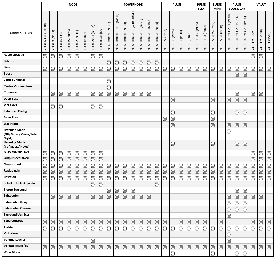

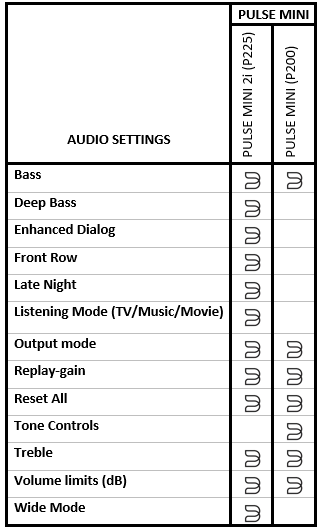

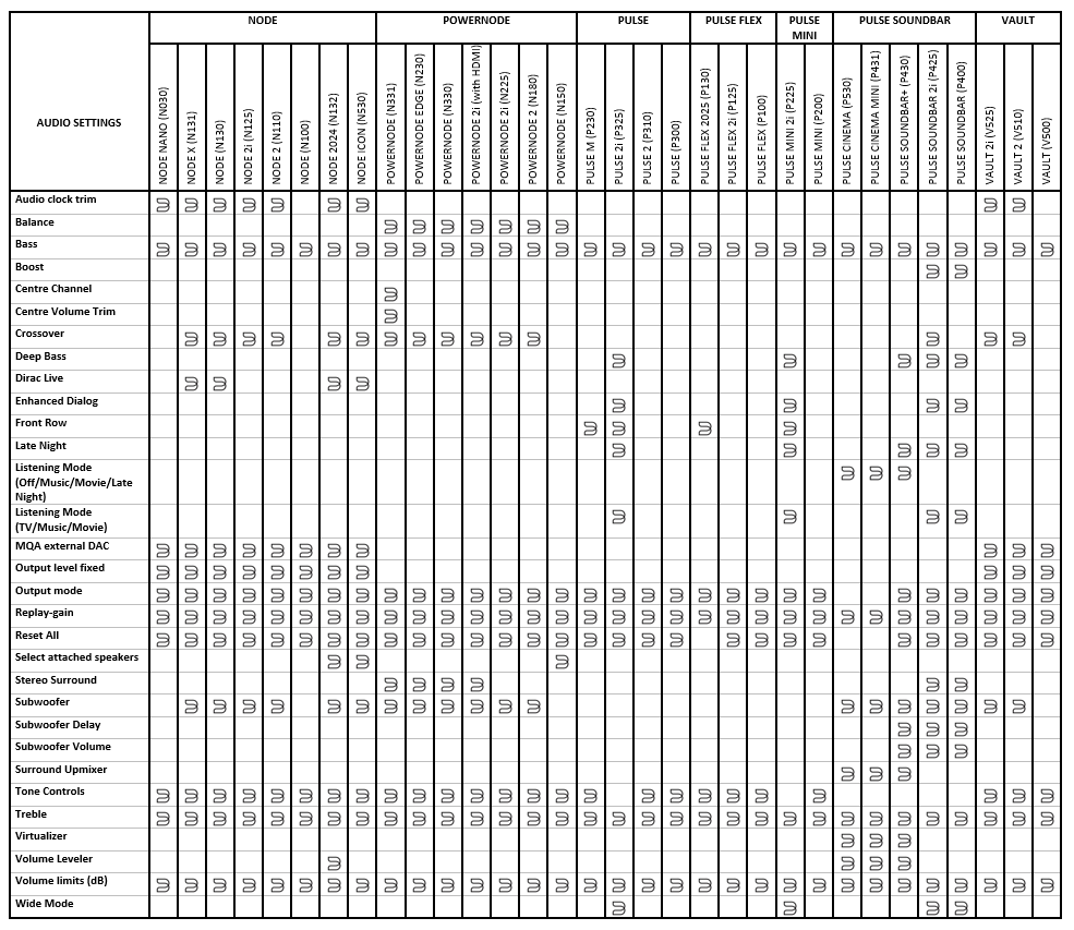

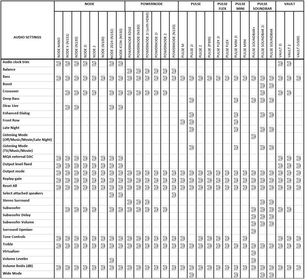

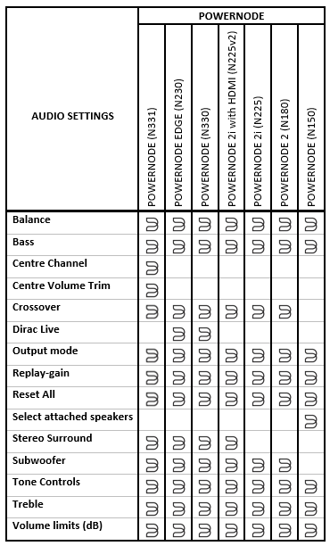

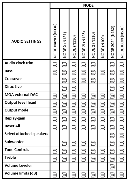

Note: Upgrade the BluOS firmware of your Player to get the latest Audio Settings menu options available for your Player. Audio Settings menu options vary depending on the model of the Player. Click below for details:
NODE Series Audio Settings
POWERNODE Series Audio Settings

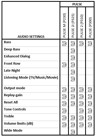

PULSE Series Audio Settings

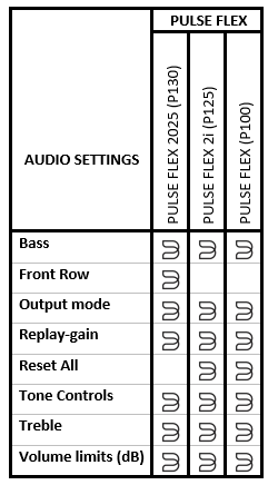

PULSE FLEX Series Audio Settings
PULSE MINI Series Audio Settings
PULSE SOUNDBAR Series Audio Settings

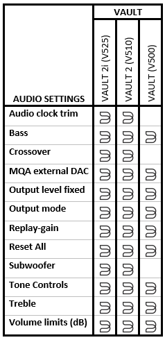

VAULT Series Audio Settings

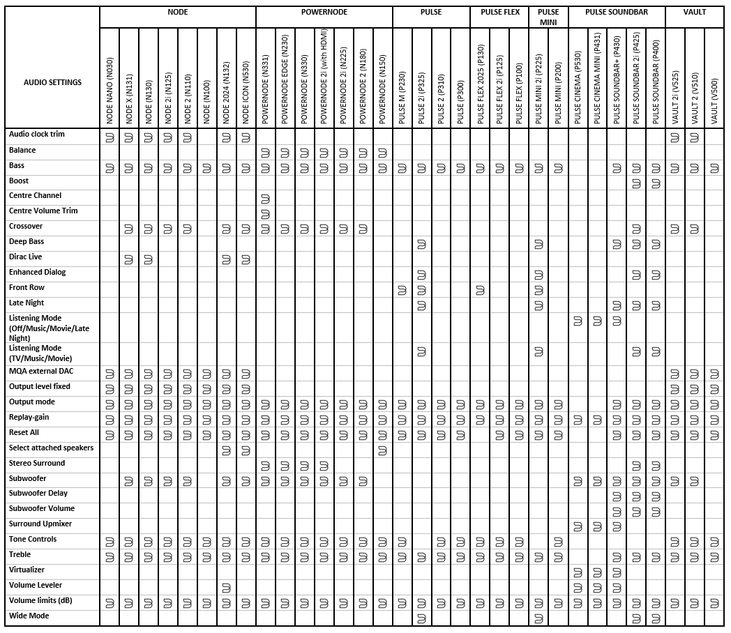

The following Audio Setting menu options vary depending on the model of the Bluesound Player:
| AUDIO SETTING | DESCRIPTION |
| Audio clock trim | Enable to reduce jitter and increase audio clock timing precision when using an external DAC. Note: Not all DACs can handle this. If audible clippings or dropouts occur, disable Audio Clock Trim to avoid BluOS' accuracy setting from interfering with the external DAC's firmware. |
| Balance | Adjust to balance audio volume on the left and right channels. |
| Bass | Adjust the Bass output levels of your Player. |
| Boost | Enable to add additional bass when you pair a Subwoofer. |
| Centre Channel | Enable to activate the centre channel speaker output. |
| Centre Volume Trim | Enable to get access to the centre channel trim slider, and adjust the centre channel level from -10dB to +10dB. Raising the trim makes the centre clearer by lowering the left and right channels, while lowering the trim reduces only the centre channel. Note: Only available when Centre Channel is enabled. |
| Crossover | Adjust the crossover between 40Hz and 200Hz – by default, set to 80Hz. When the Subwoofer option is enabled, everything above the crossover is filtered out and sent to the RCA and Speaker Outputs. The Player sends anything below the set crossover out of the Subwoofer (SUBW) OUT. |
| Deep Bass | Enable to add additional bass to your listening experience when you do not connect a Subwoofer to the Bluesound Player. If you pair a Subwoofer, enable Boost to add extra bass. |
| Digital Passthrough | Previously called MQA External DAC. Enable this option when you require an MQA-certified external DAC to handle MQA unfolding rather than the BluOS Player. Note: To enable MQA external DAC, you should enable the Output level fixed and disable – Tone Controls and Replay-gain. Learn more. |
| Enhanced Dialog | Change this setting to Low or High to increase the volume of the centre channel. The centre channel broadcasts dialog in movie soundtracks and television. |
| Front Row | Enable to create a custom-tailored filter that provides a listening experience similar to being seated in a front row of live music performances. Enabling Front Row also disables other audio settings. For more information, refer to the Help Centre article. |
| Late Night | Enable to turn on the Dynamic Range Compression that prevents large spikes in volume when streaming audio. (Ideal for small areas such as apartments or condos.) |
| Listening Mode (Off/Music/Movie/Late Night) |
Adjust settings within these listening modes to create separate listening profiles for Off, Music, Movie, and Night – that you can select to enjoy different listening experiences quickly. After configuring these Listening modes, you can change them directly from the Player Drawer in the BluOS Controller App or program an IR remote to select different listening modes. |
| Listening Mode (TV/Music/Movie) |
Adjust settings within these listening modes to create separate listening profiles for TV, Music, and Movies – that you can select to enjoy different listening experiences quickly. After configuring these Listening modes, you can change them directly from the Player Drawer in the BluOS Controller App or program an IR remote to select different listening modes. |
| Output level fixed | Enable to fix the volume of the Bluesound Player at the maximum level. It helps when you control volume using the external device connected to the Bluesound Player instead of the BluOS Controller App. |
| Output mode |
Select any of the following to configure the channel output on the Bluesound Player:
| Replay-gain |
Select any of the following to configure consistent volume levels between tracks in the play queue:
BluOS uses the metadata of the selected audio track to configure consistent volume levels between tracks. |
| Reset All | Restore the audio settings of the selected Player or Listening Mode to the default factory settings. |
| Select attached speakers |
Select any of the following to configure the Speaker/Subwoofer setup connected to the Player:
| Stereo Surround | Enable to mix two-channel sources into the rear surrounds of a home theater group, generating an immersive and natural-sounding surround experience. |
| Subwoofer |
Select any of the following to configure the Subwoofer setting:
When you pair a PULSE SUB+ with a PULSE SOUNDBAR, selecting Subwoofer displays the PULSE SUB+ Audio Settings. Note:
| Subwoofer Delay | Enable to add additional audio delay to a Subwoofer. |
| Subwoofer Volume | Adjust the volume of the connected Subwoofer relative to the PULSE SOUNDBAR's volume by +/-6dB. |
| Surround Upmixer | Enable to change channel-based audio (from 2-channel till 7.1) into a virtualized surround sound environment. Enable for Stereo Surround in a Home Theater Group. |
| Tone Controls |
Enable to adjust your Player's Treble and Bass output levels. Notes:
| Treble | Adjust the treble output levels of your Player. |
| Virtualizer |
Enable to virtually experience Dolby Atmos content. Use this option to expand the audio soundstage of any source. Enable along with Surround Upmixer for the widest soundstage with a stereo source. |
| Volume Leveler | Enable to maintain consistent playback volume levels regardless of the source selection or content. |
| Volume limits | Set the upper and lower limit of volume controls in the BluOS Controller App. Modifying the upper or lower volume limits of the Bluesound Player allows more fidelity when adjusting the volume. |
| Wide Mode | Adjust the Bluesound Player's audio output to add depth and match the viewing/listening area in three selectable modes – Off, Wide, and Wider. |
