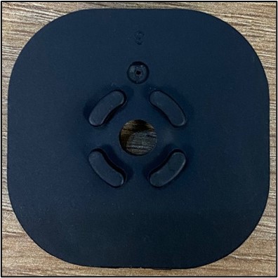

The mounting bracket consists of the following components (supplied in the box):
- Rubber mount attachment
- Metal mounting screw
- Metal Mounting bracket

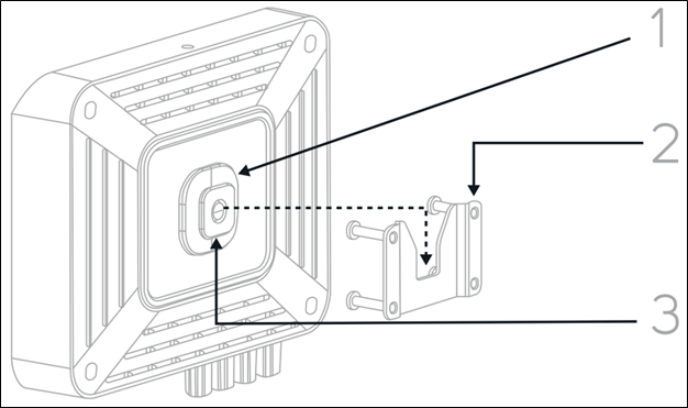

To mount the POWERNODE EDGE with the mounting bracket to a wall in any direction, perform the following steps:
- Connect the Rubber mount attachment to the bottom panel of POWERNODE EDGE using the Metal mounting screw.
- Mark the location of mounting using the Metal mounting bracket. Ensure mounting location does not conceal electrical wiring or plumbing. Pre-drill each hole for mounting screws (recommended M4–0.7 x 3, 4 pieces, NOT supplied). Anchors may be required. Be sure to leave enough space to plug in the cables. Secure the Metal mounting bracket to the wall.
- Slide the POWERNODE EDGE with the rubber mount attachment onto the bracket. Push down to secure.
