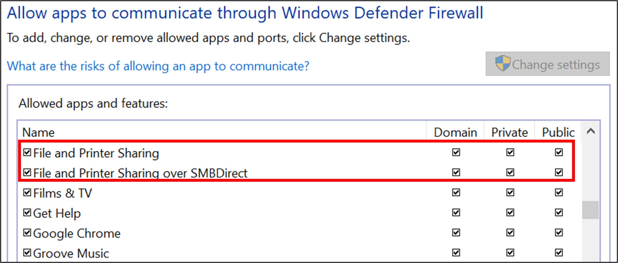

Windows Defender Firewall
Windows Defender Firewall may block required traffic for File sharing.
Perform the following steps to resolve this issue:
- In the search box next to the Start button on the taskbar, type windows defender firewall.
- Select Windows Defender Firewall from the list of results
- In the left pane, select Allow an app or feature through Windows Defender Firewall.
- Select Change settings in the upper-right corner.
- Enter the required admin credentials.
- Select File and Printer Sharing and select all corresponding checkboxes under Domain, Private, and Public.
- Select File and Printer Sharing over SMBDirect and select all corresponding checkboxes under Domain, Private, and Public.
- Select OK.
