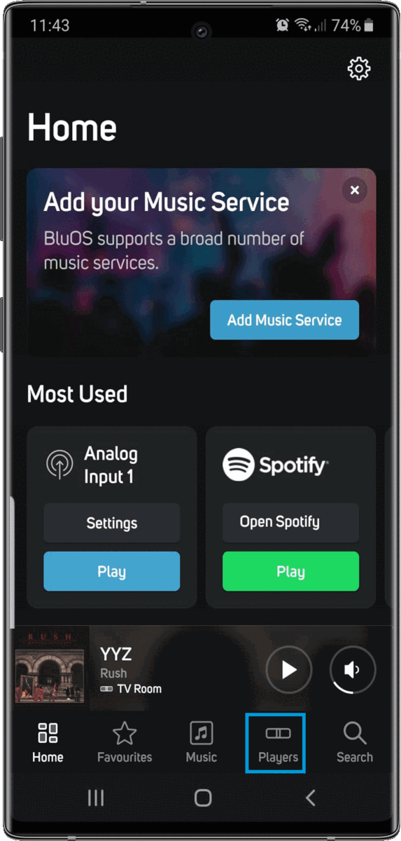

Android/iOS - Connect Bluetooth Headphones
- In the BluOS Controller App, select the Players tab
. The list of players connected to the BluOS Controller App is displayed.
- Select the required Player’s context menu (3 dots) and select Bluetooth Headphones. A list of available Bluetooth receivers is displayed under DEVICES.
- Select the required Bluetooth headphones from the list. Once paired, the Bluetooth headphone is moved to MY DEVICES and is indicated as Connected.
- Tap Finish.
You can now stream audio directly via the connected Bluetooth headphones.
The name of the connected headphones is displayed in the Now Playing Control. The quality indicator on the right indicates if your connected headphones are AptX certified.
The name of the headphones is also mentioned under the connected player with a Bluetooth logo on the player icon in the Players tab .

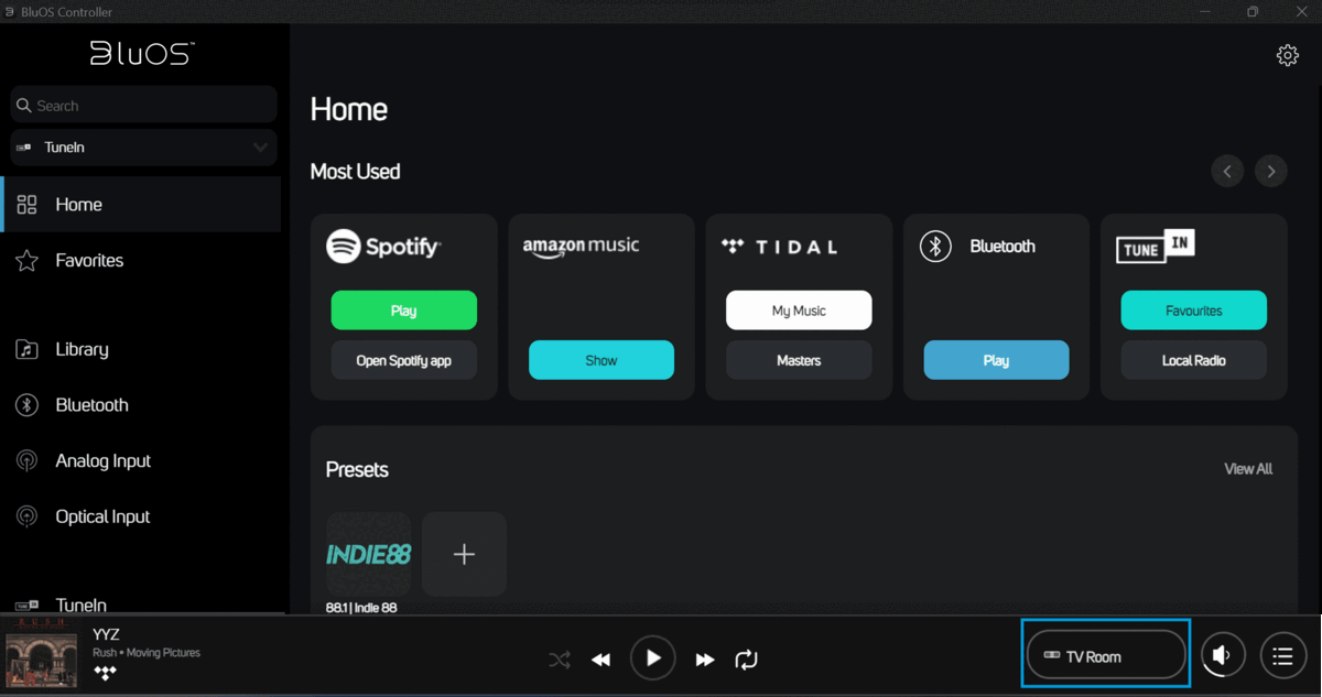

Windows/macOS - Connect Bluetooth Headphones
- In the BluOS Controller App, select the Player Drawer.
- Select the required Player's context menu (3 dots) and select Bluetooth Headphones. A list of available Bluetooth receivers is displayed under DEVICES.
- Select X to exit the Bluetooth Headphones setup window.
The name of the connected headphones is displayed on the Now Playing Screen. The quality indicator on the right indicates if your connected headphones are AptX certified.
The name of the headphones is also mentioned under the connected player with a Bluetooth logo on the player icon in the Player Drawer.

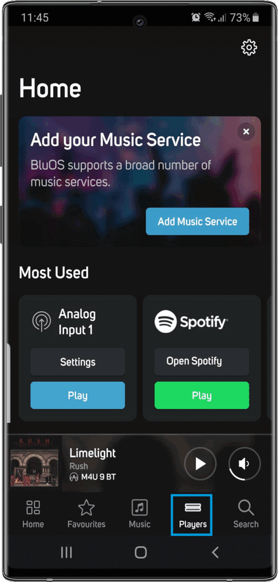

Android/iOS - Disconnect Bluetooth Headphones
- Select the Bluetooth Headphones-connected player’s context menu (3 dots) and select Bluetooth headphones.
- Under MY DEVICES, select the overflow menu (3 dots) of the connected Bluetooth headphones, and select Disconnect. (To reconnect, select the Bluetooth headphones under MY DEVICES).
Note: To unpair and forget the device, select the overflow menu (3 dots) of the connected Bluetooth headphones, and select Forget this device.

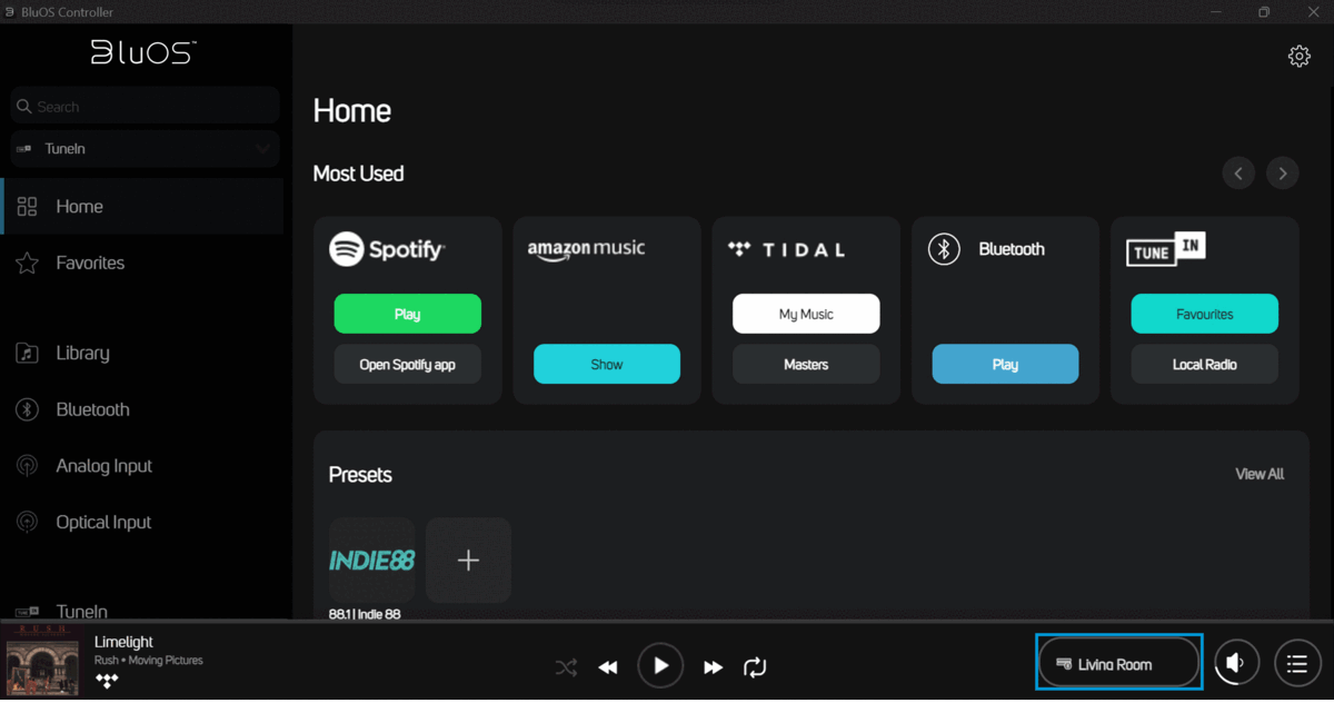

Windows/macOS - Disconnect Bluetooth Headphones
