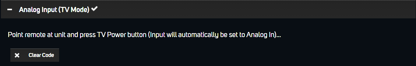

- Select Player > IR remote > IR Learning. The list of available programmable functions is displayed.
- Select the required function, point an IR remote at the Bluesound Player, and press the button to be assigned to perform that function on the remote.
- A checkmark appears next to the function, indicating that the IR programming was successful.

Delete IR Remote Code
To clear any remote configuration, perform the following:
- Select the programmed function (with the checkmark).
- Select Clear Code. The checkmark next to the function disappears.
Note: Select Clear All at the bottom of the list to reset the entire remote function configuration.
