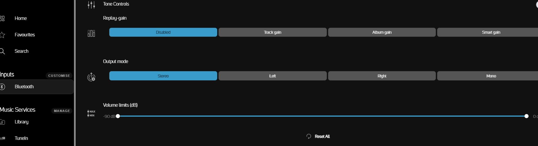

I'm probably missing something incredibly obvious, but the context menu seems only to take me to Audio Settings:
Audio Settings looks like this:
but nowhere do I see the "list of available Bluetooth receivers".

Hi John, you are correct what Alain suggested is for BT going TO your BluOS device.

Have you tried Settings>Player>Customize sources>Bluetooth automatic (or other)?
@ Seppi - thanks, but I had tried (should have said in my original post) and it is no different i.e. I don't get the "Select Bluetooth headphones" option.
@ Alain - thanks, but that reads as "switches to a Bluetooth source when a connected Bluetooth device starts playing audio". If I understand correctly (not guaranteed) that seems like a connection process for e.g. a 'phone to play through Bluesound via Bluetooth - I want Bluesound to plan and listen via the headphones!

For the benefit of others, it turns out that "Pulse Flex and Pulse Mini do not have two-way Bluetooth."
