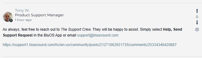

As always, feel free to reach out to The Support Crew. They will be happy to assist. Simply select Help, Send Support Request in the BluOS App or email support@bluesound.com
https://support1.bluesound.com/hc/en-us/community/posts/21271062931735/comments/25334346420887
