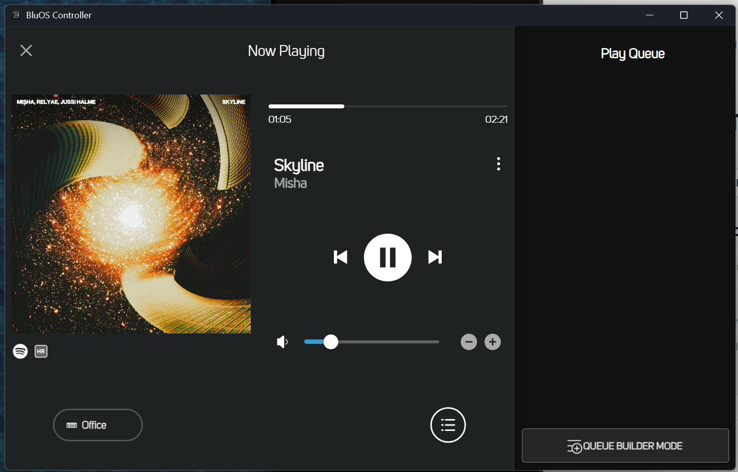

is the Play Queue feature on the BluOS Controller App - I tested Windows and Android - supposed to show anything? On my Node Icon it always shows empty as per screenshot below. In this case I'm running a Spotify Playlist so I'd expect all coming tracks to appear.
If I close the BluOS controller, the player do run through the playlist as expected.
Any hint what I'm doing wrong?

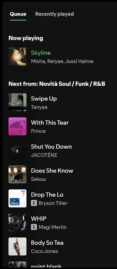

and Spotify indeed:
The BluOS App will not show what is next in your Spotify Play Queue. This is expected behaviour as there is no mechanism in the Spotify supplied SDK to pass this information forward. The expected usage is when using Spotify Connect, you are doing so using the Spotify App as per Spotify's requirements.
Therefore if I do use Radio Paradise, Radio and Spotify only it is never going to show anything. Would do only if using providers alike Qobuz, Tidal and others.
