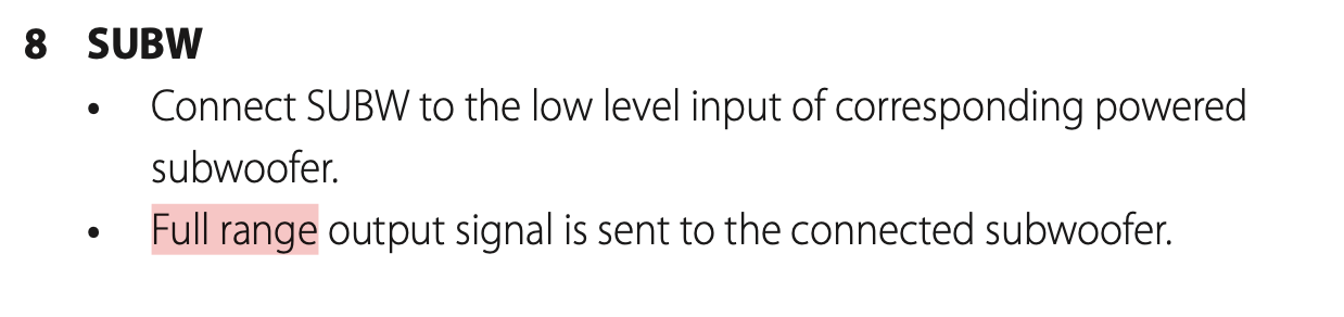

AnsweredI recently purchased a NAD 3050, and prior to buying it I reviewed the manual to ensure that the subwoofer output provided a full-range signal, which it clearly states.
Unfortunately, that does not appear to be the case. In reality, both a low-pass and a high-pass filter are dictated through the BluOS app. The subwoofer cannot be used without setting a crossover point, which I find very unusual.
