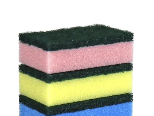

Got rid of the sticky surface using scouring pad hard side (?) see photo. Didn't get anything resolved but was rubbed off - a bit of a work but looks fine. I am not sure if the sponge do any harm to surface but dent look like it
