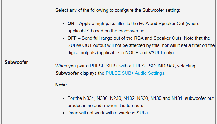

With the release of the NODE N132 and NODE ICON late last year, we have had to make modifications ot the SUB Woofer setting in our NODE family of products to meet DIRAC Calibration requirements. The switch used to be Crossover-enabled or not. This actually confused a number of consumers who implied the setting was Subwoofer on or off, which is in fact what it does now.
That being said, it should not affect the crossover point. If it is, please send us a log file by selecting Settings, Send Support Request in the BluOS App so we may take a closer look here.
Full details in this Help Centre Article; https://support.bluos.net/hc/en-us/articles/360036429314
