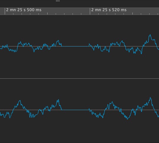

AnsweredHas anyone else noticed that a very small silence gap is now being inserted at the beginning of tracks streamed from Amazon Music, disrupting the flow from track to track for gapless recordings.
I noticed this with BluOS v4.10.13 on a Node 2 and is being observed on Digital and Analog outputs as a very short pop.
I have a 2nd Node 2 with BlusOS v4.8.21, and this issue is not observable on that Node (it was unplugged when the other was updated).
Reference example is Pink Floyd - The Wall, with the transition from track 2 to 3.
I recorded the analog output for the transition from track 2 to 3 on this album and the attached image shows the gap. This is repeatable.

Sorry we missed this. Thanks for bringing this to our attention. Our Quality Assurance team has been able to replicate it. Our Product Development Team is hoping to publish a fix in the very near future via software update.
