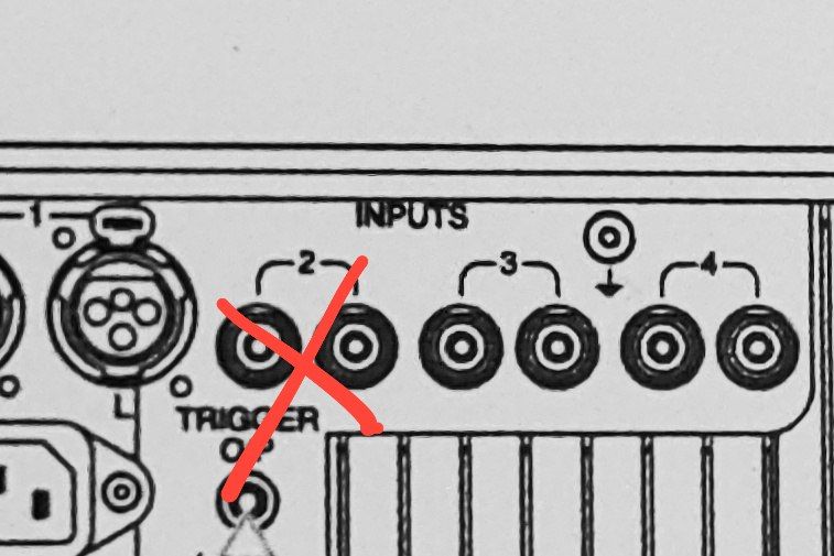

I solved it by connecting the ICON and the amplifier simultaneously with both XLR and RCA cables. The strange thing is that it was only quiet when connected to the two RCA input terminals on the amplifier that are adjacent to the grounding terminal; there was no change at all with the other one.0
