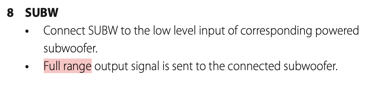

    Having the exact same issue. ASW608 and CE3050. Almost every time a song is skipped or when the new song starts, a clear and semi-loud *POP*.
    Really annoying. Also, very strange that a low ánd high-pass filter is forced in the BluOS app. Even though the manual clearly states that a full range output signal is sent to the connected subwoofer.
