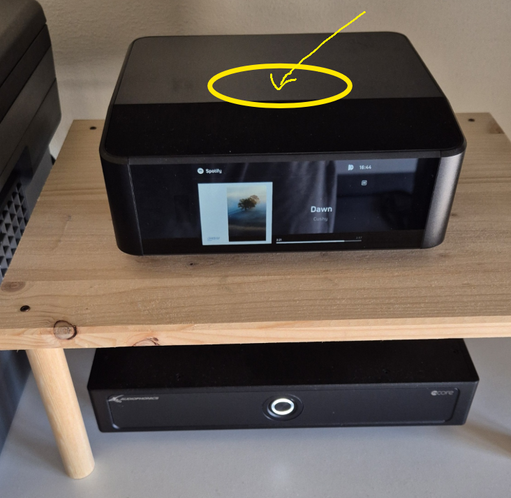

[edited] Bluesound Node Icon becomes very hot and disconnect from WiFi after upgrade to 4.16.22
BeantwortetMy Node Icon is connected via WiFi to the network and streams Spotify for several hours a day (background in my home office).
I noted that recently it becomes very hot in one specific spot at the center of the top (see picture). This part is warm even when in stand.by, does neve get cold as the rest of the chassis, and becomes hot - I mean, touching it you cannot stan with your fingers on it - while in use.
One day it suddenly stopped, I believe due to thermal protection as I had to get it cool down a bit before streaming. It sits on top of a wooden little rack I created so it does not sits just above to the power amplifier.

Offizieller Kommentar
Hi SKA
It is not unusually for home electronics products to run as high as mid 40Cs. To be sure though, feel free to select Send Support Request in the BluOS App. One of our Support Crew will reach out and gather some more details.
