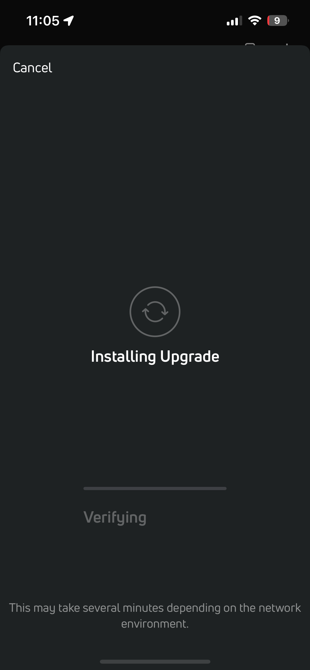

My node x is also having issues since the last software update.I followed the advice above, turn off router, turn off node etc however the node doesn’t appear in the app
I then manually tried to add it to my network and a box pops up saying updating software which it then fails to do
When it was working, I checked and it said no software needed updating
I’ve done a factory reset too but it still doesn’t work!

I have basically the same issue on my Powernode Edge. After last firmware update in Bluos bricked the device. Now it displays the red ring of death. I did the factory reset, the device restarts, I connect it with the Bluos app which looks for device updates which bricks the device again.
Hi Lucas, are you connected to your Router using WiFi or Ethernet? If WiFi try Ethernet (and vice versa), the EDGE is so small and light moving it closer to the Router for an Ethernet connection (without the speakers) is an easy thing to do.
Hi Seppi,
Fortunately, I’ve managed to fix the issue. I have a mesh network at home where the Powernode was connected via Ethernet to a satellite router. When I connected the Powernode to the main router, the update process finished successfully.What I find strange, though, is that the BluOS app was detecting the Powernode even when it was connected to the satellite router, so I’m not sure if moving the device to the main router was actually the deciding factor.
