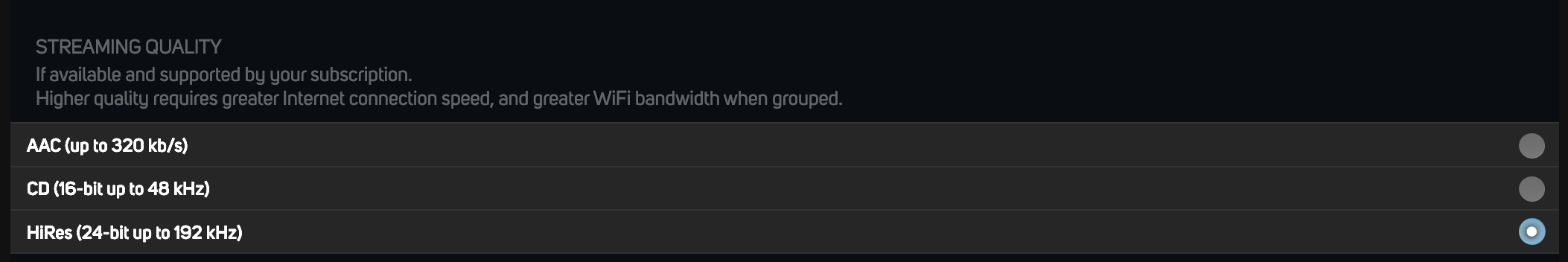

Hi,
Please make sure that streaming streaming quality is set to HiRes in BluOS. To check this, select Manage in music service, select Tidal and confirm that HiRes settings is selected. See screenshot below for reference.
For 1:1 assistance, please feel free to send us a support to support@nadelectronics.com and a member of our support crew will be more than happy to assist you.
