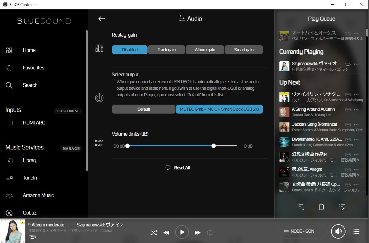

Although the USB digital output on Bluesound Node is designed to have a "fixed volume," it may have a "variable volume" depending on the USB DDC/USB DAC used. This occurs depending on the model, even if the USB device supports USB Audio Class 2.0.
I reported this issue on the forum, and then had a long discussion with the support team, including log analysis. In conclusion, it is a "bug", but there is no clear answer as to when it will be resolved, and it has not been fixed to date.
After trying various workarounds for this issue, I also found that repeated "Reset All" operations on the audio outputs sometimes reverted to a fixed volume. (However, it may need to be repeated several times and may not work.)
